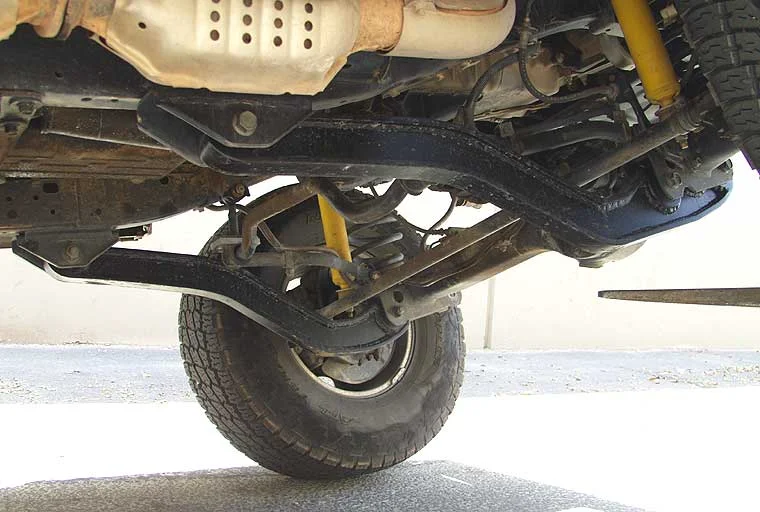

ini88;401321The unlinked arm would prevent it from wrapping and also flexing at all.[/QUOTE said:
http://forum.ih8mud.com/attachment.php?attachmentid=454204&stc=1&d=1285606558
I think...and I don't know, because I'm armchairing this...but isn't this the theory behind superflex radius arms?
Wait a second...why not just replace one of the radius arms with a 3 link style arm (one bolt at the axle housing) ?
Wouldn't the remaining radius arm prevent axle wrapping? Granted it would be taking additional stress, but it seems beefy enough to take it...
N/m...I see that d90 already did this experiment years ago. 5" more on the ramp.
In the front you are doing the opposite, bumps are hitting the 3 link directly first then move past the radius arm.
So if I understand correctly, the radius arms can sort of behave like the lower links on 3 link if you removed the front of the two bolts holding the radius arm to the axle.
What is missing is something on the axle that prevents it from "wrapping" when it hits a bump. the front radius arm bolts play that role on the standard defender front suspension.
