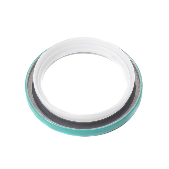

Is it possible to fit the T seals and the rear main without the seal guide tool #270304? Or, anyone have specs on how to make a set?
I’d read around a bit. There are a few techniques, including coating the seal in RTV to lube and seal it. Another option is skipping the seal and filling the cavity with an RTV like Right Stuff. Whatever you do, use the best materials and care possible. Pulling everything apart again to fix a leak there sucks.

Thanks. I’m waiting on rod and main bearings to show up today, then finish up the bottom of the engine. The finish up the back which now I see I need to make some kind of sleeve
/tool to let this clutch hosing seal slip over the end of the crank.
The white conical plastic piece that comes with the new seal is the tool to slip the seal on.
I don’t have that. Gonna have to make something out of plastic.
Never seen a rear seal come without that piece. Are you sure?

I’m sure. This is the orange rubber seal. Pic in a minute.

I'd consider picking up one of the green ones. Then you'll have a spare and the tool. I believe they're sold as Corteco or OEM.
I’m pretty sure my corteco seal was orange and it came with the plastic tool. As did a Victor Reintz seal. Where are you? Perhaps someone close by you has one they could give you. It’s just a cheap piece of plastic.
I’m in Pittsburgh, PA. I’m just going to make one out of a 2 liter plastic bottle.
