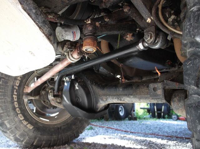

Because my homemade diff gaurd sticks out slightly further than before, the stockish bend panhard rod did not fit anymore.
So I made a new one out of .188 wall tubing I already had.
I tried to get fancy and made the axle end too close to the gaurd.
So I will make another one slightly longer on that end tomorrow.
