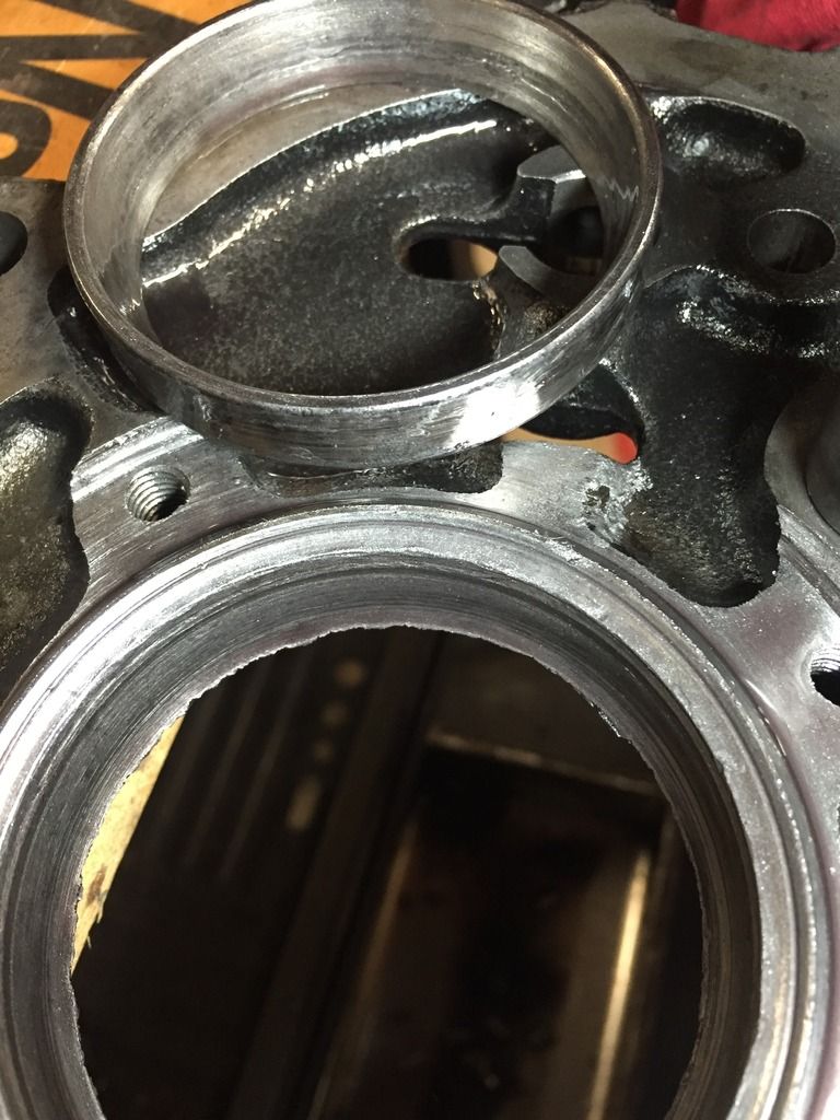

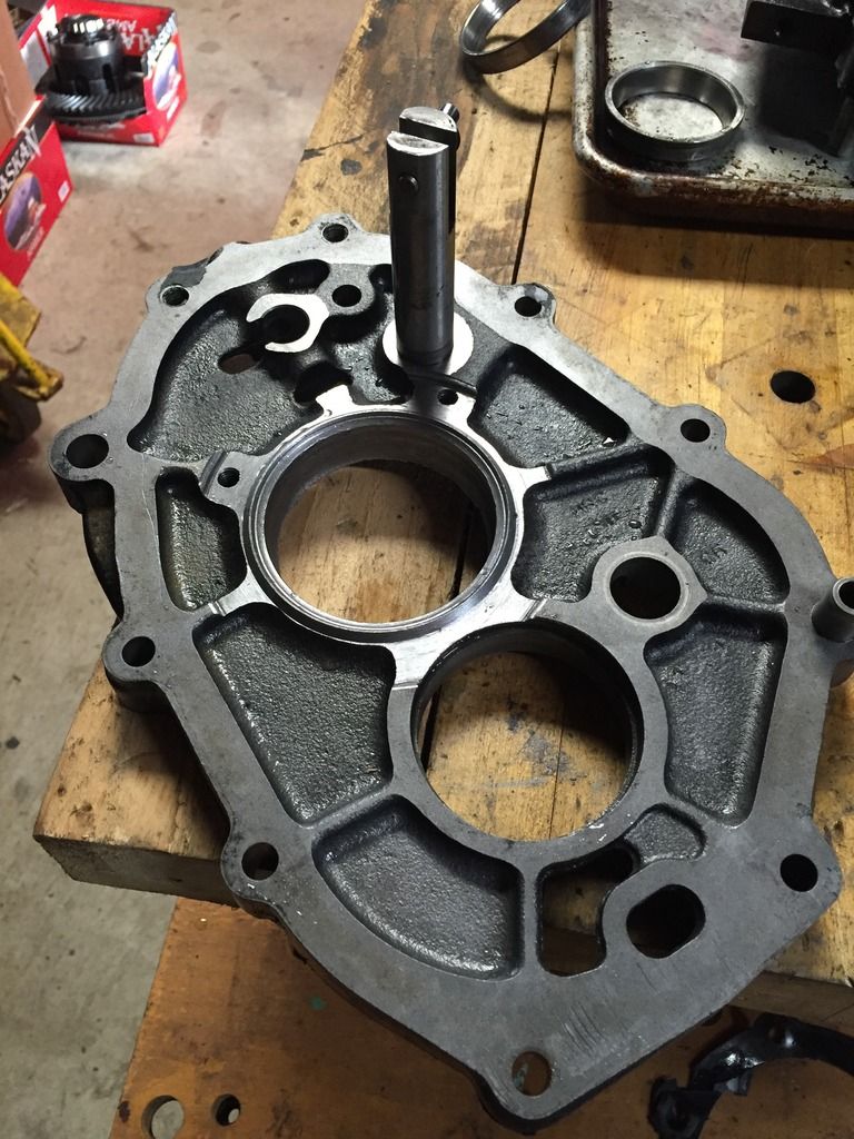

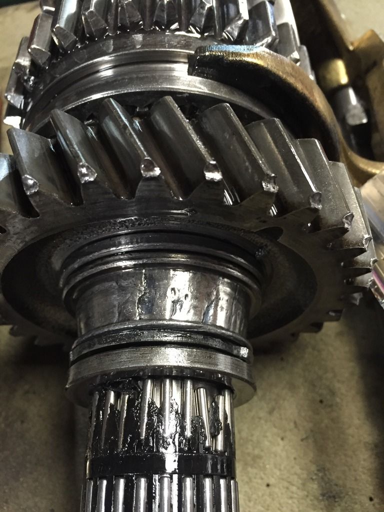

Hello, I was having transmission problems, I tore down the transmission to find that the rear bearing on the mainshaft housed in the center plate had failed. The bearing race also spun in the center plate and has made the center plate unusable. Does anyone have a LT77 center plate or know where I can get one. Thanks for you help.

You could try Ashcroft or try and find a used piece. The parts manual only only lists the entire case as a part number.
You will need to provide the suffix as the cases change over time. Be careful spending too much. I assume that is an early suffix box and it will just fail again one day.

Is it from an F suffix? If not, it won't work as they changed the bearing size for F.

I no longer need that part. Im getting a transmission from Southwest Rovers.
Also, I found out that you can not replace the center plate alone. You need to replace the case and the center plate as a set due to the fact that they are machined as a set. Make sense to me.
